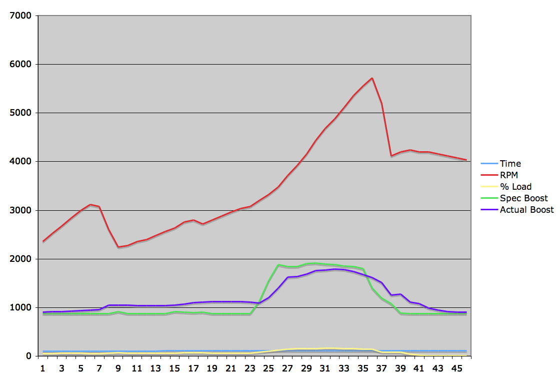

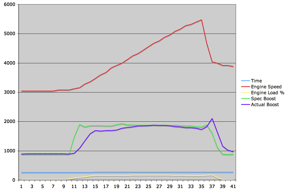

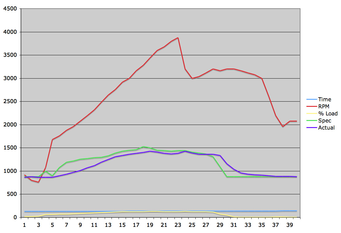

    I did a few pulls with a VAD-Mobile today and graphed the results.
    Car is a 2001.5 S4 Tip running OC.t Stage 1
    3 Graphs attached. What I am wondering about is the "lag" behind the requested boost and the actual boost delivered. And, on the 2nd graph...the "spike" of actual boost after I've lifted off. Is this normal, or is there something to be looking at?

            I think what Jeff was asking is specifically if the lag is normal, and if the boost spike at the end (when he closes the throttle) is normal in these cars.
            These logs are not useless, Jeff is not testing for total boost, or if the boost is falling off at higher rpms, he's just asking if the lag is normal or not.
            Basically asking if there looks like there is a problem with the wastegate (no there isn't - the boost builds and holds), or with the recirculating valves (if they are closing properly, or if the diaphragms are ripped and letting boost leak back into the intake of the turbos, and if they are opening quickly enough to let the excess boost pressure flow back, not stall the turbos when he lifts off the throttle).
            I don't think that there is a major problem, although the recirculating valves look like they may be tired (ripped, well used) which I would suggest to him to check.

                I agree with Mark...although the graphs are not completely useless, they would be much more useful if they were 3rd gear, full-band pulls. Just by looking at the graphs you posted, there really isn't much to see as that spike could be caused by many things. But, if it were a full log, it would be easier to speculate what may be wrong. As always with these cars and boost issues, you can always check the dv's and wastegate lines...if have a couple brand new 710N's sitting around if you need them...

                          You may have a small boost leak, as the boost ramp is a little slow, but not out of the normal range. You probably have a torn DV causing your boost spike when letting off the throttle. If you replace the DV's and the spike still occurs, then you should test the N249 valve.

                            What I noticed as well is the little vacuum line between the diverted valves was quite loose and frayed. When moved back in place, everything feels much stronger. I need to replace it.
