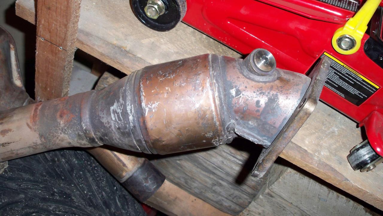

Just got my downpipes out last night goddam that was not fun lol. Gonna do all the gutting and welding today. Just out of curiosity for those of you that have completed the mod, did you have to extend the wires for both sets of o2 sensors to reach the new bungs? Or just take em off the firewall and re route em some other way. As well if I do have to extend the wires, is there any problem with resistance etc if I cut and solder 1 or 2 feet to each set?

c5 a6 2.7t 6spd,Thanks ryan I read all about your aggravation and learning fun hahah. The 1st set is completely removed but I will prob take out the seconds to do the soldering. Is that how you did yours or were you able to make them reach?

They'll reach. And if you build the dp's so the O2's don't reach, you can extend the wires with no problems.Jordan

Alright, reachin is better than soldering. Just finished gutting the pre-cats and welding everything back together. Thank god for 2 inch drill bits, drill presses and friends with excellent welding skills! They look great and hopefully perform and sound the same! re-install starts now...

Just have the rear O2 bungs welded as close to the end of the cats as possible and you'll be fine. You will probably have to snip a couple of tie wrap's to get some more length on the leads but no big deal.2002 996TT

Got everything back together running smooth little bit more turbo whistle not noticing huge power gains but need to get aftermarket mufflers and take out resonator as well. I did get engine codes after driving for about a half hour, now this was most likely the f**k up on my part....when i relocated the o2's i plugged the ones right before the precats and then relocated them to the next bung down the line. The secondary o2's were relocated right after the secondary cats as per all the pics and info I had gathered...is this why I am getting codes?
17526 - Oxygen (Lambda) Sensor Heating; B1 S2: Open Circuit
P1118 - 35-00 - -
16514 - Oxygen (Lambda) Sensor B1 S1: Malfunction in Circuit
P0130 - 35-00 - -
17522 - Oxygen (Lambda) Sensor; B1 S2: Internal Resistance too High
P1114 - 35-00 - -

The primary O2's stay up top before the precat, don't move these. Plug the original bungs for the secondary O2's and place them after the main cats. Make sure all of your connections are good, reset your codes and see if they come back again.Last edited by The Brice; 04-25-2010, 03:57 PM.2002 996TT

So u think those codes are related to the placement of the 1st set of o2's and hopefully not my wiring/soldering skills? I dunno how i pulled idiot and plugged the wrong ones. Oh well more skinned and ravaged hands here we come! Anyone taken out the resonators and done a muffler delete on there s4's and been happy with it?
