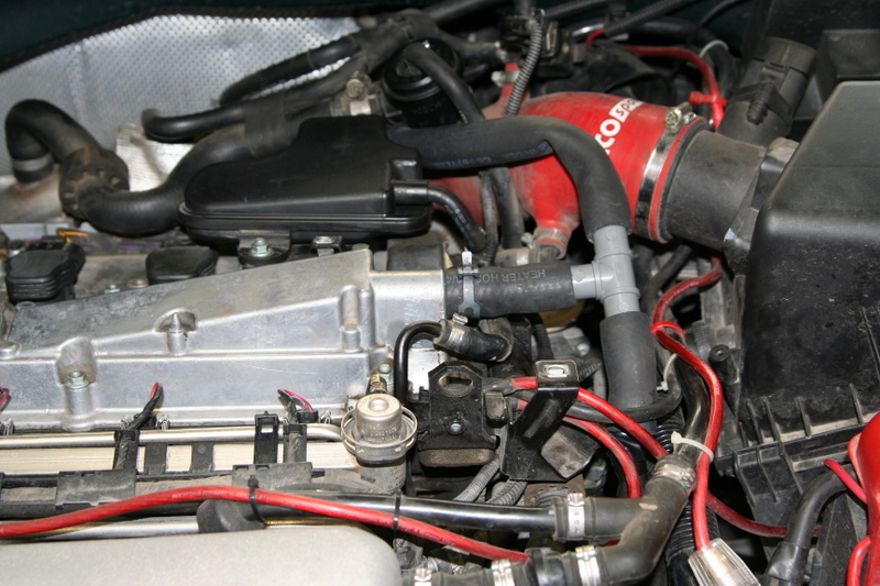

                  Just a tip if you want to save money
                  You can get some black rubber hose that is the exact right diameter at Auto Value or any of those shops. Its heat proof and is just plan black, like a radiator hose.
                  Then you can just buy a black plastic Y fitting and use that to make the Y shape. It all hooks up nicely with hose clamps.
                  It won't look pimpin' but it probably costs $10
                  Edit: Or just use the hose to go into a catch can.

                          Read a bit on vortex and went ghetto heater hose route as Kor mentioned. Hose was 3 bucks, couple clamps and the T (3/4 x3) is from underground sprinklers for a couple bucks.
                          Attached pic of it. Beats paying 40+ for another wimpy hose. Only issue is the engine cover won't be going back on anytime soon.
