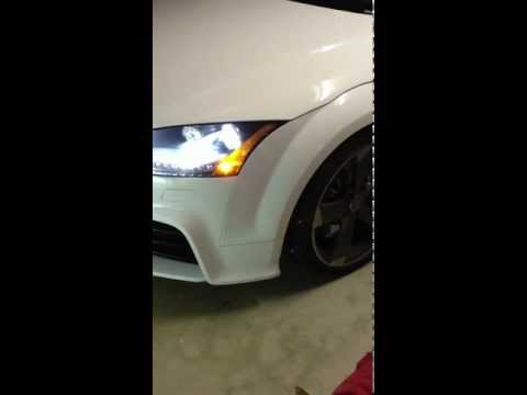

                        the ttrs makes a rattling sound associated with the chain tensioner, i wonder if its the same problem?? there was a software update the fixed it for some. something about increasing the oil pressure and the sound goes away, but audi says no damage is being done... who knows

                              we have done more of these and we are seeing that the tensioner is allowing access play at start up and this causes the keeper on the tensioner to fail.
                              here is a video of the bad start ups. If you have a rattle at start up please get this done
