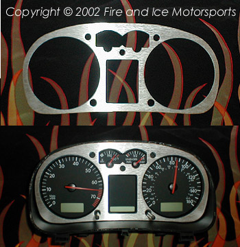

Does anyone know how to get enough dash apart to get a brushed aluminum gauge bezel onto the cluster? I don't even know where to begin.

why not just get one of these??
but i will help you out, and save you from breaking your cluster...
i. pull that leatherish trim out (the thing just above the steering column, grab it and yank)
ii. then there you will see 2 torx screws holding cluster in, unscrew.
iii. slightly pull cluster out, and you will see 2 harnesses plugged into it in the back, you must undo them, to do this, lift the purple clips from the bottoms up, and the harnesses will pop out. now you have cluster out...
iv. DO NOT start prying the front plastic off, IT DOESNT COME OFF THAT WAY.
v. there are 2 more torx on the back, undo those, then about 3 clips top and bottom, undo all that, and the front plastic will come off... then its up to you to figure out the rest, i guess just put it on... never done it before.
