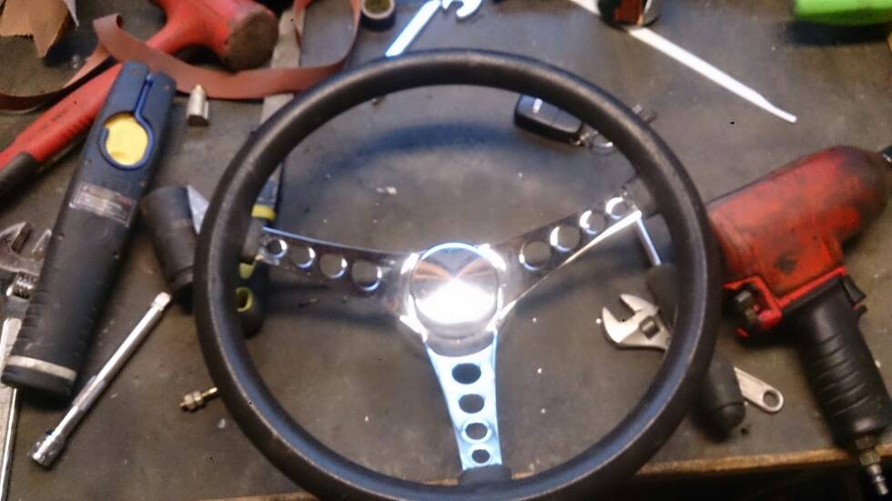

                              Well here's this weekends project...wanted to wait til it was done and stained but I couldn't wait to show it....I wanted a nardi but don't want to pay.....so I am trying ti make my own. I bought a cheap wheel off Kijiji for 15$

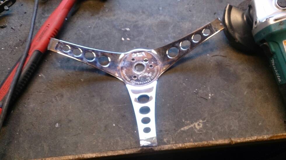

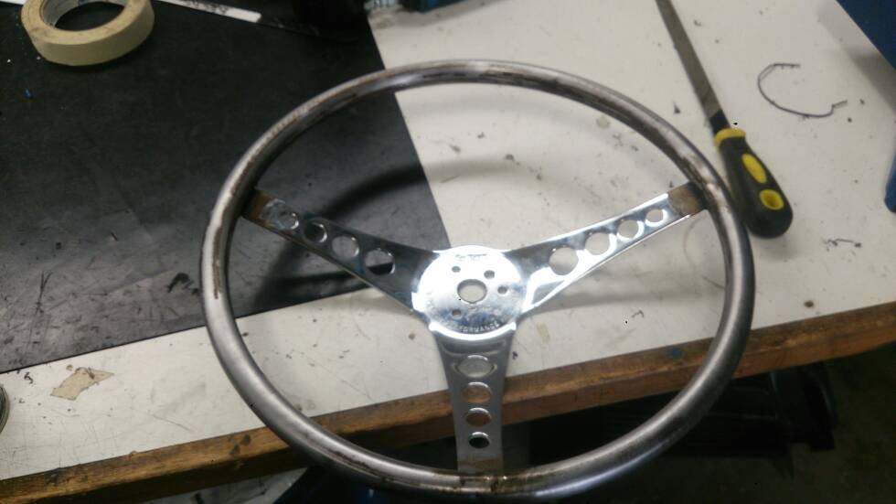

                              Took off the foam...realized the inner bar was too thick.. Tried to cut it in half and fold it into a smaller diameter but it got all fu„%ed up so I removed it completely and left with just the center...

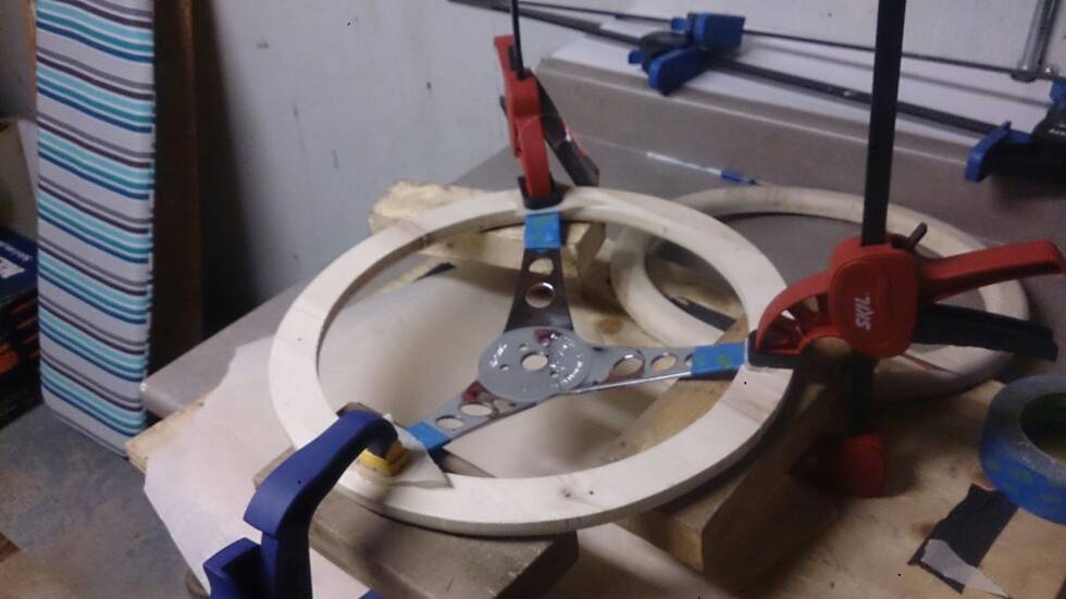

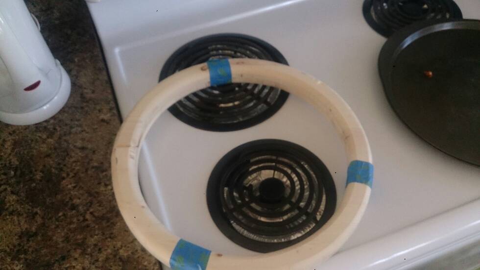

                              Then I took some 3/4" sheets of wood and routed two circles..then used a round over bit to......round out the edges
                              Then mated the two together..
